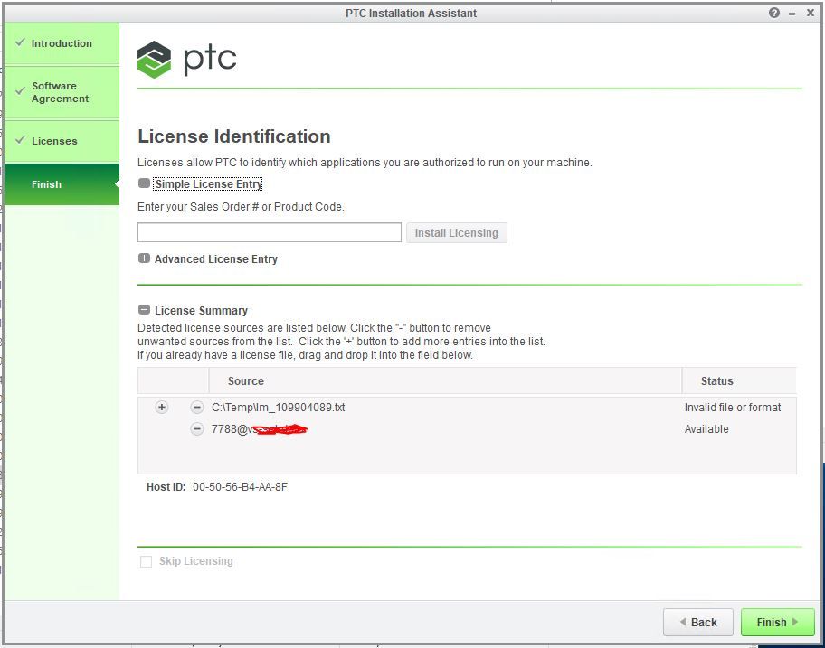

I am using Creo Parametric - Release 5.0 (connected) Release 5.0 and Datecode5.0.5.0
We are trying to install an updated node-locked license for Flow Analytics on a PC with a floating Parametric license.
When we add the new license in Reconfigure on the PC it displays 'Invalid File or Format'
Any suggestions?

please publish picture of reconfigure window. Also publish picture of the license file.
Martin Hanák
@AR_7917108 wrote:
1st picture
Host ID: 00-50-56-B4-AA-8F probably belongs to Virtual Machine.
I do not understand why you are installing Creo Parametric on Virtual Machine. Can you explain it ?

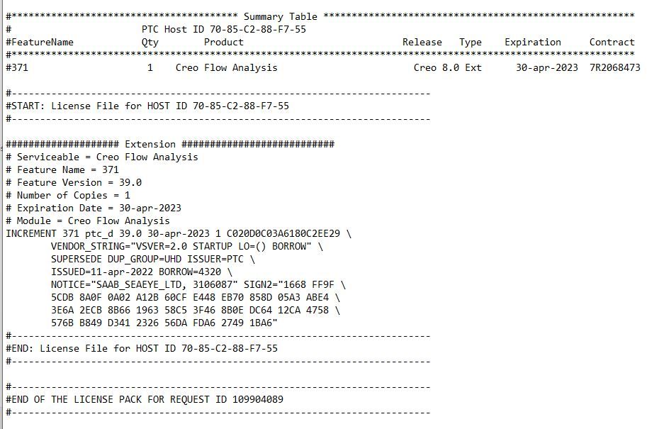

2nd picture
I hope it show contents of C:\Temp\lm_109904089.txt file. Is it true ?
This license file is pure nonsense.
Module 371 Creo Flow Analysis is not node-locked, it is floating.
Module 371 Creo Flow Analysis is Extension, this means it must be installed on the same Host ID as basic Creo license (floating -OR- node-locked).
Solution of the problem ... you have to move Creo Flow Analysis to the "Creo Parametric" license server.
Martin Hanák
The virtual machine is the floating license server for Creo - however the same error is displayed if I try and install the license using reconfigure on the actual PC.
Yes that is the path to where the license file is.
So are you saying I need to get the MAC address in the file changed to be that of the license server? I do not want the Flow license to be floating I only want a single PC to be able to use it, how do I achieve this if the license is on the license server?
Q: So are you saying I need to get the MAC address in the file changed to be that of the license server?
A: YES
Q: I do not want the Flow license to be floating I only want a single PC to be able to use it, how do I achieve this if the license is on the license server?
A: See following information.
On computer using Flow license, <CREO_LOADPOINT>\Creo 5.0.x.0\Parametric\bin\parametric.psf file must contain following line
ENV=CREOPMA_FEATURE_NAME=PROE_YourLicenseName (371)
On computer NOT using Flow license, <CREO_LOADPOINT>\Creo 5.0.x.0\Parametric\bin\parametric.psf file must contain following line
ENV=CREOPMA_FEATURE_NAME=PROE_YourLicenseName ()
