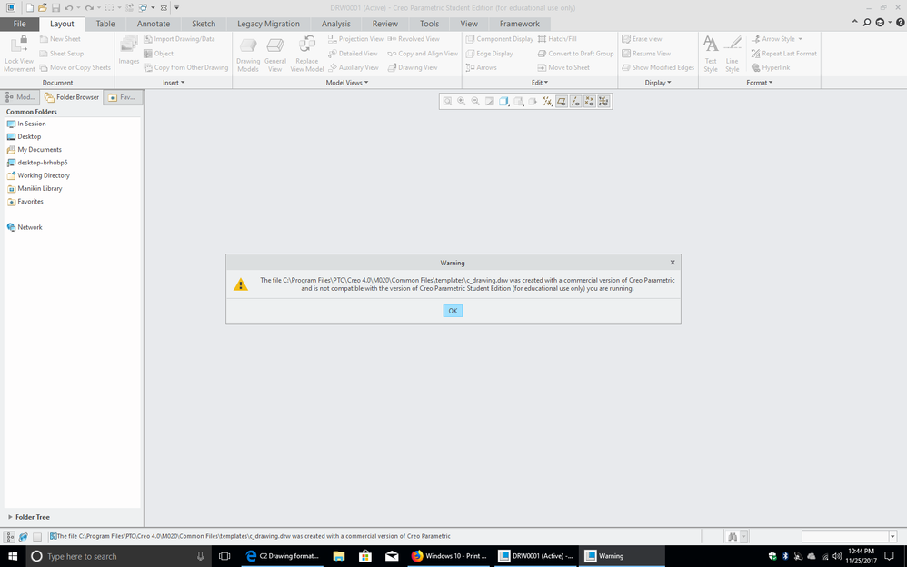

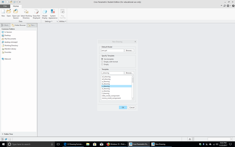

I am trying to get a lesson done for my Creo class which requires creating a drawing of a part. I have Creo 4.0 Student Edition for Windows 64-bit Pro. However, I get the following warning which says that the drawing templates that came with this student edition where created in the commercial edition and cannot be used!!! How can i get Student versions of these?
Templates are not required to make a drawing. You can just choose EMPTY and then a sheet size.
If you have formats for your school, you can add the format afterwards or if you know a format up front, you can choose, EMPTY WITH FORMAT to select a format.
Templates are something that companies (or maybe schools) custom build to apply certain standards to the drawing. The key is they are custom and some "generic" template would be mostly worthless.
