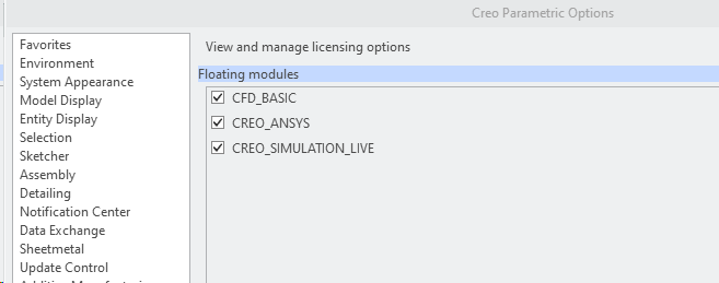

Welche Lizenz benötige ich zur Verwendung von "Creo Ansys Simulation" in Creo Parametric 11.0?
Creo Ansys Simulation or Creo Ansys Simulation Advanced license is required.
https://ptc-p-001.sitecorecontenthub.cloud/api/public/content/48a884b4550d46368c594e1621ab918e
you can run ptcstatus.bat to see whether CAS license is available. AFAIK it is sold as separate item, this means it is not included in Creo license.
