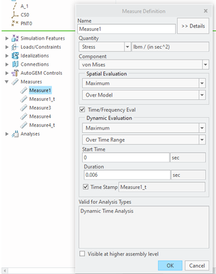

I have finished a half-sine 30g impact shock analysis, however, I can't plot any results even I have defined some "measures". What could be wrong?!
 What could be wrong in setup?

What measures did you define and did you confirm that they are valid for the analysis you are trying to do?

You are right, the comparison on time usage is not fair, except that it is easier to get results and plot results in SolidWorks Simulation because there are far less buttons to click in SW so there is less chances to trip off. (And this is the first time I try to learn SolidWorks Simulation to run half-sine impact shock analysis! It took far longer time to define correctly the half-sine curve in CREO than in SW for a first time user). I defined one measure as follows:
There might be somewhere wrong in the definition. Thanks for your time.

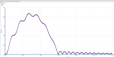

I finally got the plot. When defining a measure, it should be evaluated at each time step.
If you define a measure as I post in my original post, CREO would allow you to spend time to define it, but doesn't show anything. (Then, what is the point to allow me to define it?)

Thanks for the hint, I found them (measures defined by myself) in the xxx.res file.
