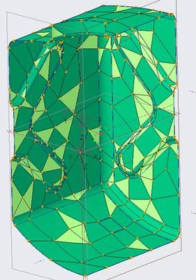

Hi
My name is enrique, I have some questions about Simulate
In the created mesh there are two green colors (light and dark) that represent each tone of color and with what criteria they are formed?
And other question:
"Relief of inertia"
Is it like a state of balance? I mean when there are no restrictions and you put it in sum of forces = 0?
Regards
light green = element-tri
green = element-quad
Inertial relief
Simulate automatically applies body loads that balance your applied loads that affects the displacement solution but not the stress solution.
Inertial relief

thanks for the information helped me in my work!!
