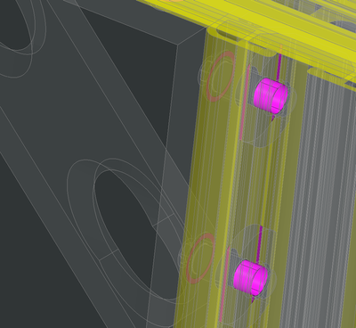

I’m trying to run an FEA on a fixed support beam, I replaced all the bolts with “intelligent fasteners”. I keep getting the “cannot process highlighted contacting surface” error

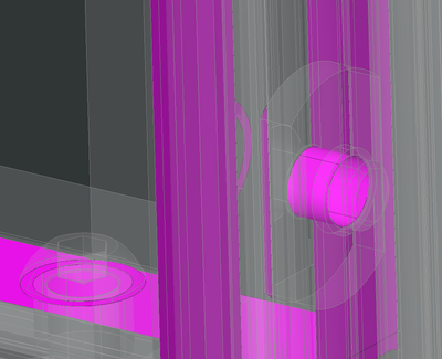

Sorry, man, but you have black model with black edges. There is still 0 visibility on the problematic region. try changin model color to white/light gray. take a screenshot without first part than without the other. Describe problematic region in text and include simulation features applied to them. What kind of interface you are using. Most of the time those are tangential surfaces. But can't prove it from those screenshots.
Problem understood.
What you are looking at are 3 40mm x 40mm aluminum profiles with 2 heavy-duty (HD) corner brackets holding them together. I am attaching screenshots and a .zip with a SolidWorks assembly (the assembly is imported into CREO). I will work on better screenshots of the actual highlighted surface of the profile.

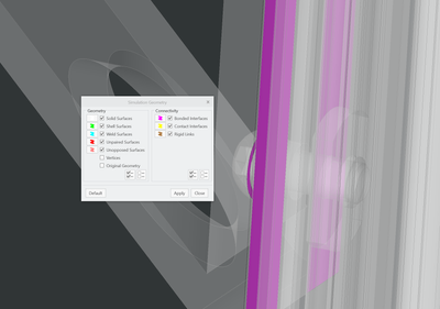

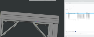

The first thing I noticed was very different part and assembly accuracies. It is best if they are all set to 0.01mm. This could very well be your issue. Make sure coincident surfaces are actually coincident and there are no interferences.
Tools - Tolerance report will show all the tolerances.

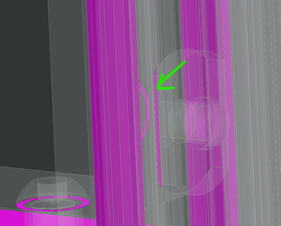

The T-nuts were not in contact with the rails in my model, and they had interference with the bolts.
t-nut moved into contact
Nut sized to match bolt
