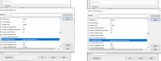

JE_11013556
6-Contributor
(To:Alexia)
Hi Alexia,
Sorry for bothering you again.
I modified the advanced options below and added svg and tiff. Since the current project includes svg and tiff files. Unfortunately, images are still not visible. Do you have any idea? Maybe the root cause of our problem was the DTD or the stylesheet where using? Which we don't know yet.
Jay
Alexia
(To:JE_11013556)
Hi Jay,
Unfortunately it will be trickier for us to guess what may be causing the issue.
I would like to recommend you raise a support case with the PTC Technical Support team as you will then be able to share sample files and do a Desktop share to try to track down the issue.
Best wishes
Alexia
