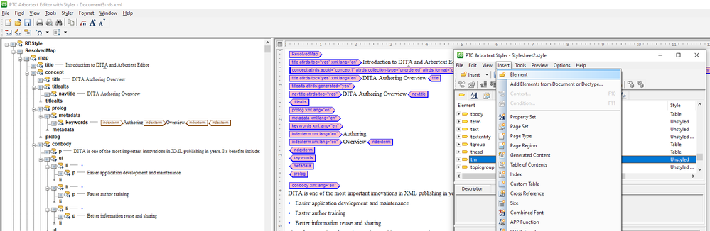

On the screenshot below I've intentionally deleted the "Title" element from the stylesheet, so it's not available / visible in Styler.
After clicking Insert - Element the element will be added and actually styled based on default stylesheet setting for this kind of elements ("Title" in this case).
