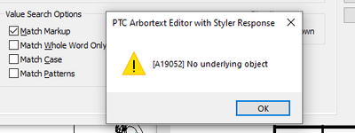

Thanks for the response Clay, I have a lot that I want to change, If you do it in RDE I get this message. It works as expected in a topic.
BRyon
Do you have the topics checked out/locked? You may need to select "File->Edit All Entities and Inclusions" to make sure everything in the RDE is editable.
That was it Clay that was the magic setting that I was missing.
Thank you.
Bryon
