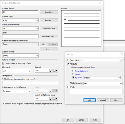

One level down, however, the (chapter) numbering style switches to A,B,C,... and I am unable to style the title numbering to start at "B" (whether starting from a fixed start position or using an attribute).
By default, numbering for this level starts at "A", as one would expect. However, if I click on "Start at" at this level, it gives me a default fixed value of "1", rather than "A". If I set the fixed value to "2", this shows in the preview in the dialog as "B", but the published result is still to start at "A". It's as though this setting is being completely ignored.
Attempting to use an attribute to tell the numbering to start at B doesn't work, regardless of whether I give it an attribute of "B" or "2"; it just starts at "A".

Turns out, setting a fixed value of "2" (to indicate B) does work (my PDF output settings were overriding my base settings).
However, using an ancestor attribute set to "2" still isn't working for me. This is what I'm trying to do:
