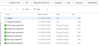

The Arbortext Editor 8.2.3 download is missing some DCF files for DITA v2.0.
Where can I download files for:
doctypes\dita\2.0\bookmap\dita20-base-module.dcf
doctypes\dita\2.0\bookmap\dita-map-module.dcf
doctypes\dita\2.0\bookmap\dita20-map-module.dcf
I was getting an error because it did not find the DCF files in the doctypes\dita\2.0\bookmap folder.
I copied the missing DCF files from the  dita\common\dcfmodule folder to the dita\2.0\bookmap folder.
I no longer get an error message.

These files can be found at :
[EditorInstall]doctypes\dita\common\dcfmodules
If this resolves the question for you please 'Accept as Solution'

I see them there.
If you don't see them there, it might be worth trying to repair your installation, or do a clean reinstall of Arbortext. When you (re)install, check to make sure any options for DITA 2.0 are selected for installation.

I also see them there in my vanilla installation.
As recommended by another User, it may be a worthwhile repairing your installation, or uninstalling and doing a fresh installation.
Do not make any changes or add any customisations and firstly check the fresh install.
