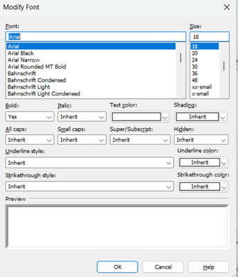

You can do that from Edit>Modify Font Menu.
Partner
(To:Vinod_Pimple)
I don't see Modifiy from the edit menu, only have Modifiy Attributes... and Modify Processing Instruction which is grayed out.  Please provide the complete steps.
Thanks.
If you highlight your text then choose format, font it will wrap your text in a font wrapper.
