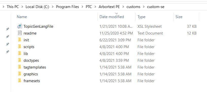

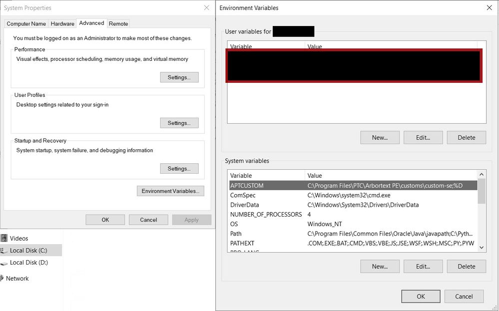

Mine is also similar situation but, I am configuring with HTTP. The error is coming only when I set the APTCUSTOM environment variable to set the custom folder. If I remove the APTCUSTOM custom it will connect with client and URL also work fine to publish PDF with standard style sheet. Could anyone help me to resolve this.

Can you use APTCUSTOM with PE? I have never had success with that. I have the application copied and pasted into the application folder.

Yes I am using APTCUSTOM in PE. I have created a customs folder which have all my defined style sheet inside. I have attached a images for your reference.Environment Variable SettingEnvironment Variable SettingFolder structureFolder structure

Thanks for the screen shot. When I have tried using the aptcustom I had it going to a network location. All of my client machines can retrieve the application, but the server would not. So my solution was to replace the default application in the install folder. Seems to work but it would be nicer if it was a reboot PE and it would automatically download the latest application.
