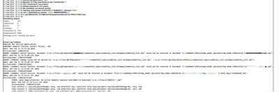

we've setup Windchill (12.0.2.x) with SSO , and Microsoft Entra ID as the CAS and IdP, which is explained in:
Microsoft Entra ID as the CAS and IdP for Windchill (ptc.com)
This is working fine for Creo, Windchill and Arbortext.
But once SSO is enabled, publishing fails, references can't be found:
Anyone faced similar issue?
best regards,
Stijn

Have you also tried by publishing a sample document?
Is this issue specific to an object when it's being published?
Have you checked the payloads, does it generate the PDF?
Manpreet Singh
sderoose
(To:manpsingh)
there is a PDF being generated, but some references, such as embedded screenshot, attributes, ... are missing.
Already tried the suggestions of Alexia but it didn't help. Fortunately we don't publish a lot, so if needed I disable SSO and publish the needed files.
But this is very annoying. Don't know why I don't get decent support from PTC tech support, SSO is supported and documented by PTC.
