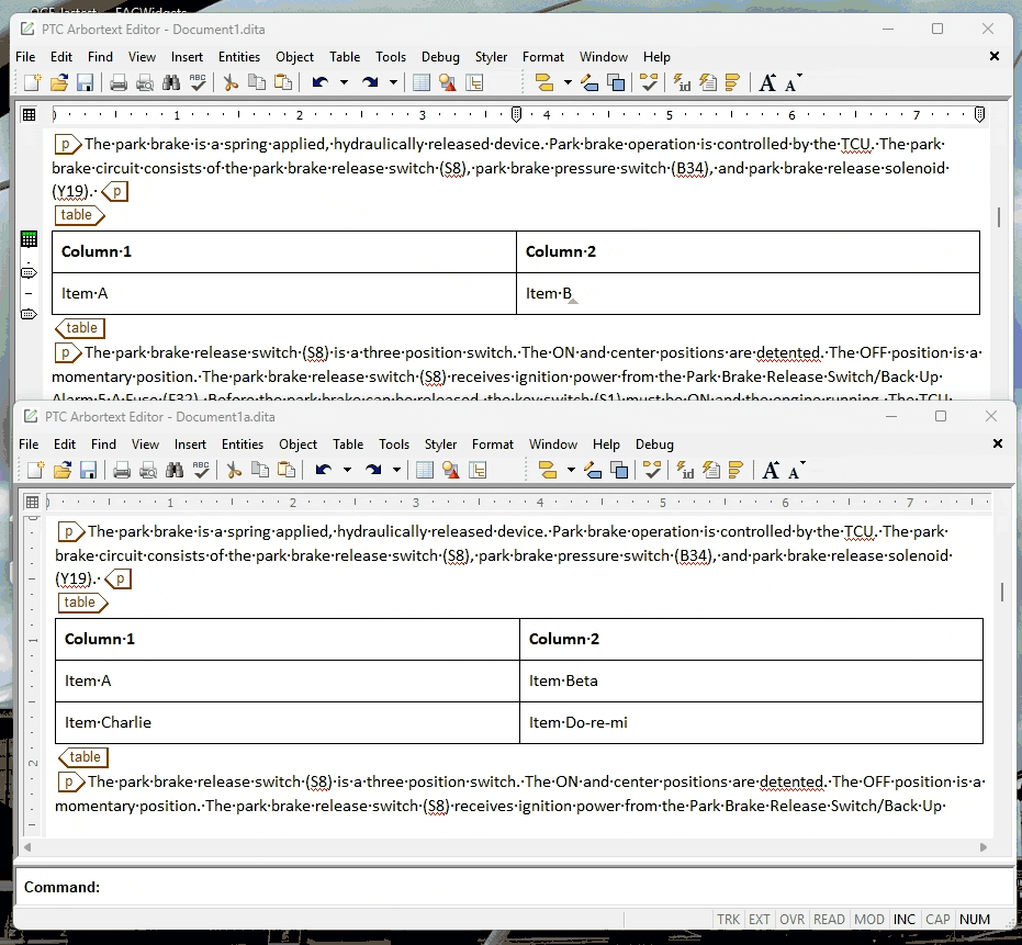

On one level, it would help to know what doctype you're using (DITA, Docbook, something custom?), and what attributes specifically are getting inserted.
However, the larger issue seems to be that you are having trouble finding meaningful changes in your documents using a text editor to do a "diff" style line-by-line comparison. I would say that's probably not the best approach to finding changes in XML documents. With XML, linebreaks can appear in many places that are not syntactically significant, to facilitate things like the "pretty printing" you mention.
But the whole point of a tool like Arbortext is to work with the document structure instead of treating the XML like a traditional text file. So, my advice would be to take advantage of Arbortext's Compare feature to do your version checking. You can open the updated file, and compare it to the previous version, and it will show you changes between the two versions in the Editor window. The animation below demonstrates the process--it's very easy. It shows you what has changed in your document structure, without being limited to line-by-line changes in the serialized file.
