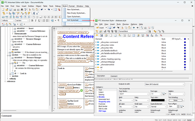

We had a stylesheet created for our company. Due to recent changes to our formatting requirements, one of two published pages in our book needs to display different content. It seemed the best approach was to copy an existing ufe (_ufe:SignatureBlock). I was able to do so in Styler, and rename the copy as desired (_ufe:SignatureLOEPBlock).
However, I can't find anyway to properly edit the markup to point at the new ufe. I checked in the forums and on the web, but couldn't locate a solution. Thanks for any help,

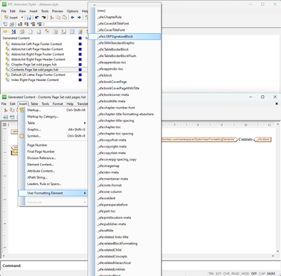

How are you editing the stylesheet? If you use the Styler UI, it should be pretty easy, open the Generated Content item you want to modify and choose from the menus Insert->User Formatting Element->_ufe:LOEPSignatureBlock.
From your screenshot, it looks like you might be simply opening the stylesheet in Arbortext Editor as a generic XML file and trying to modify it that way. That's not recommended, since the regular editor won't understand a lot of the semantics of stylesheet markup when editing that way. Also, elements like UFEs won't appear in the usual "insert element" UI widgets, so you would have to resort to using an "insert tag" command or something similar, which may be why you are getting unexpected results. Everything will be easier if you edit in Styler:

Unfortunately, I can't figure out how to add "_ufe:SignatureLOEPBlock" to the stylesheet to replace "_ufe:SignatureBlock". I attached a screenshot with some comments.

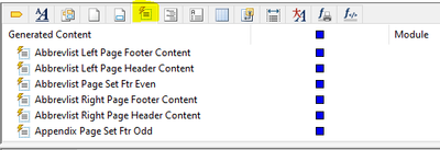

Ah, I see! The problem I had while in Styler was I didn't know how to select the Generated Content view.
Once that list populated, I was easily able to add the new _ufe element to my markup.
