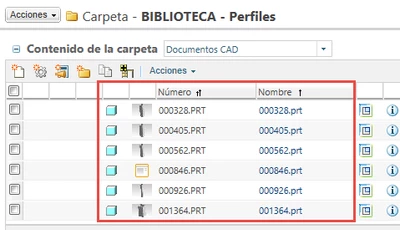

I'm trying to configure AFX to use profiles already uploaded to Windchill. I have created custome profiles that I can use if they are in my library folders, but once I upload them to Windchill, and delete the parts from my library folder, AFX can't find them in Windchill.
I have uploaded the profiles to Windchill:
I have "sel_list..txt" pointing at them:
And when I try to assemble a profile instance in the project using these profiles, I get the error message "An error occurred while loading the model":

Hi @avillena,
Currently for profiles it is not possible to store the template parts for the different profile types in Windchill.
Regards Sam
