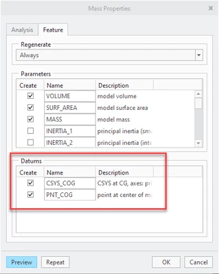

As far as my understanding goes it is necessary to get the BMX extension in order to actually drop a point establishing center of gravity.
In the Mass Properties tab if you have BMX you can save a point.  Otherwise you get the XYZ location but have to manually place a point.

Ken you are correct with a slight modification
(1) Do the mass properties analysis.
(2) Save the analysis as a CYCS and point feature named COG
(3) Show these on the drawing
(4) Relate your symbol to the CYCS and or point and you are good

Some time ago I created a guide on how to create a point on the Center of Gravity. As soon as you have the point you can show it in a drawing and put dimensions or an icon on it.
See PDF doc in the attachment.

You need to have the Advanced Assembly Extension or some form of the more advanced packages to do this easily.  Having those you can create a feature at the end of your model tree  which will store the CG.  Once stored, in drawing mode you can add a symbol or create geometry in the drawing that is reference to the CG feature.  You can lock it relative to the view and dimension it just like in your picture.

You can add to start part/assembly or in any model. I use CS0 or whatever your origin co-ordinate system is. Create a new CS from it. In the x y and z offsets use type pro_mp_cogx, pro_mp_cogy and pro_mp_cogz these will update when you recalculate mass properties and your cog position. Note there is also spin on this cog but I tend to ignore that most of the time. You can add point if you need to but should be able to locate a symbol on the CS.
