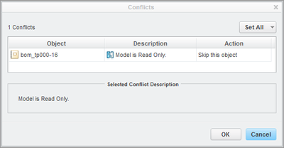

I never noticed that it did contain that information - though for certain Windchill will note all the links to it and try to drag them along. Does a declaration fail if the Notebook/Layout gets marked read-only?
You can declare objects to a notebook that is Locked (read-only) in the workspace.  You simply get the message, as shown:Objects can be declared to a Locked (read-only) Notebook.Objects can be declared to a Locked (read-only) Notebook.
As a matter of fact I was wondering if it might be good practice to check in a new notebook, then Lock it, before you declare objects to it.
