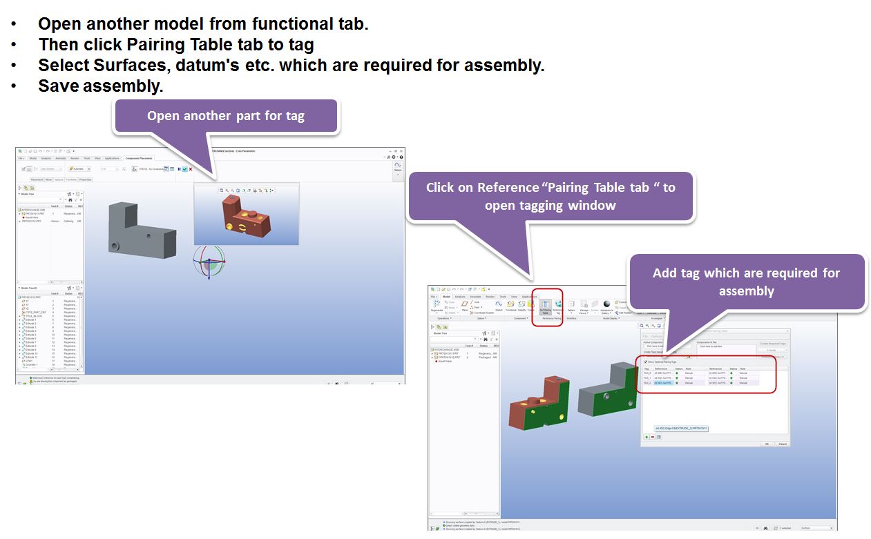

Hello everyone,
I want to use Interchange Assembly
please tell me where it is in the Creo.
1 ACCEPTED SOLUTION
Hi Akshay...

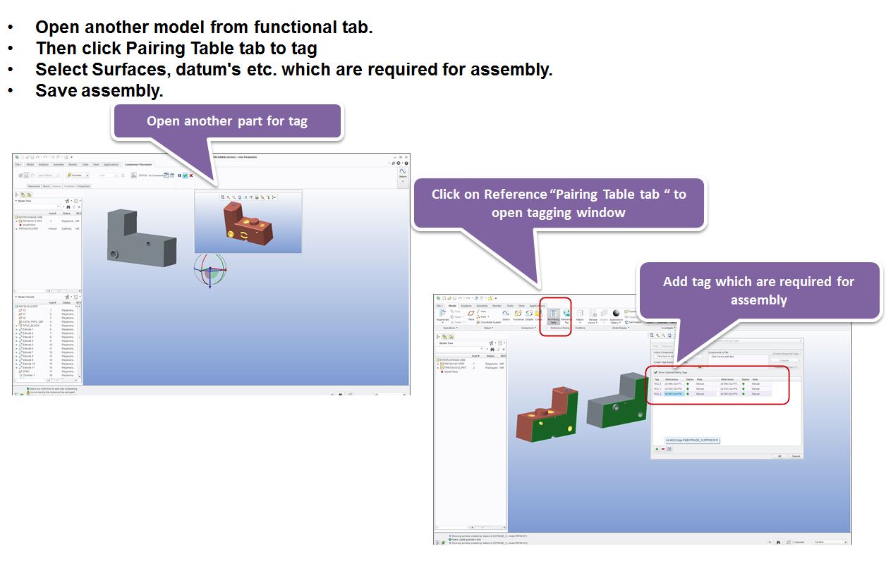

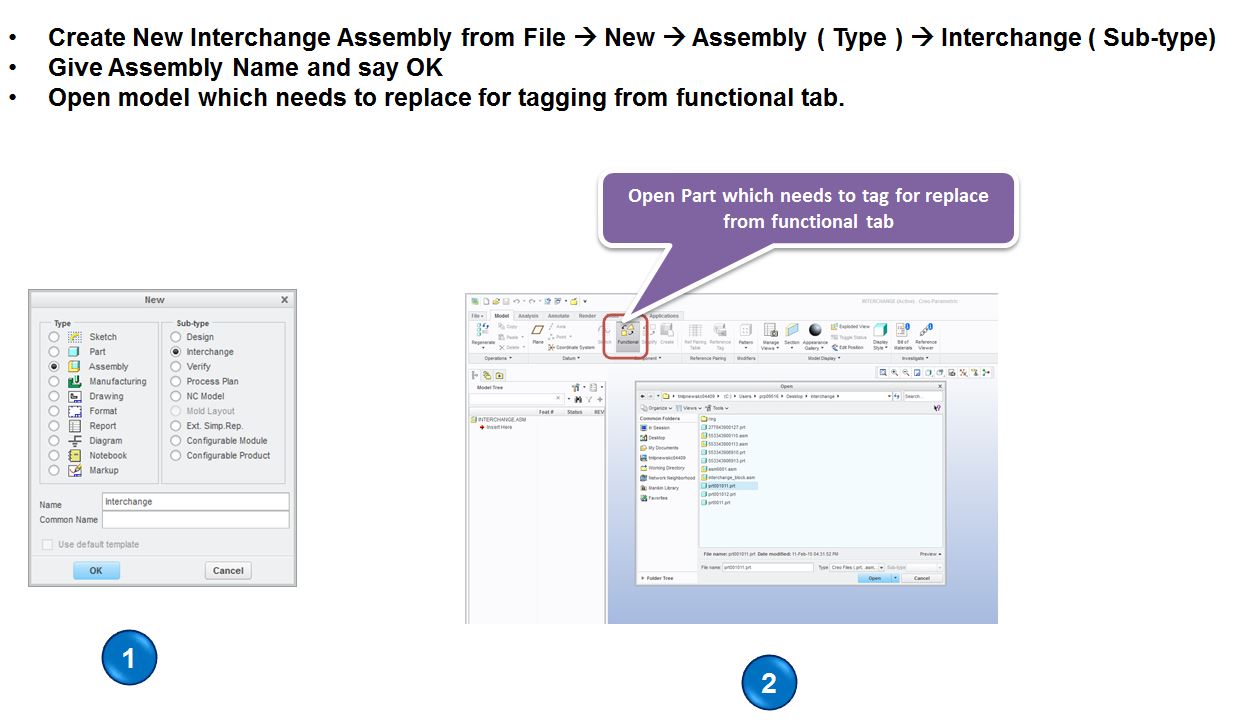

Please follow below procedure.
Create tagging:
Replace Part with required one:
Prashant Pandarkar
3 REPLIES 3
Hi Akshay...
Create tagging:
Prashant Pandarkar

Advanced Assembly Extension is required for Interchange Assembly
Hi Akshay,
Yes, the Advanced Assembly Extension is required to work on Pro/Assembly features like interchange assembly.
Also, if Prashant's response helped, please remember to mark it as the Correct Answer.
