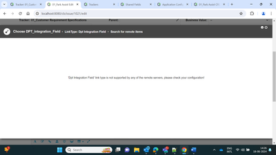

We are trying to integration codebeamer with windchill using DPT, so we are trying to add external linked items in codebeamer , but we r not able to see the server option as below.
Can anyone help us to get this option in codebeamer end or provide the steps how to add external linked items, we r getting this below mentioned error.

Hello NS_10797603,
Did you check the following guide to setup Codebeamer as a OSLC client:
https://support.ptc.com/help/codebeamer/r2.1/en/index.html#page/codebeamer/cb_dpt_integration/26334050.html
If you have done but still face the issue, then I suggest to open a support case to get further assistance.

Yes, we followed the steps but getting error, thanks for your response.

Please share the full details, the whole setup is not easy, DPT needs a middleware ThingWorx with Flow, have you installed ThingWorx Flow?
+ There is an article that you may follow: Article - CS400634 - Sample steps to configure Digital Product Traceability (DPT) in Windchill PDMLink 12.1.2 as the OSLC Client and Codebeamer 22.10 SP2 as the OSLC Server (ptc.com)
