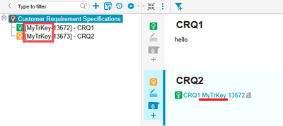

Have you tried tracker.key? It seems to work for me.
            "myitem" : {
                "link" : {
                    "text" : "${summary} ${tracker.key} ${id}"
                "popup" : {
                    "text" : "${interwikiLink} Status: ${status}; Description: ${description}"
            "myitem" : {
                "link" : {
                "popup" : {

Hi @PolarBear,
that is exactly what I was looking for. Thank you.
