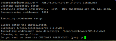

I am attempting to install CB 2.1.0.2 on ubuntu  and have done (hopefully) all of the pre-requisite steps.  When I login as the "codebeamer" user and run the installer, I get the following error:
sh MED-61402-CD-330_2-1-0-2_Linux.bin
Creating directory setup
Verifying archive integrity...  100%   MD5 checksums are OK. All good.
Uncompressing codebeamer  100%
Executing codebeamer setup...
Please enter the Installation
Directory (/home/codebeamer/CB-2.1.0.2):
Installing codebeamer into directory:  /home/codebeamer/CB-2.1.0.2
Cleaning up setup folder
Incorrect installation directory.
Any guidance on this?
-Matt

Okay so the shell debugging helped.  It turns out the `cpio` command was not installed.

I was able to interrupt the installer at some point and utilize the setup directory it created and I added `set -x` at the top of the SETUP script and ran it:

+ find LICENSE-src.txt LICENSE.txt SETUP bin config msoffice office perftesttool repository tomcat upgrade -print
+ cpio -pdm /home/codebeamer/CB-2.1.0.2
+ cleanupSetupFolderIfExists
+ [ -d ../setup ]
+ cbpath=/home/codebeamer/CB-2.1.0.2
+ tomcatpath=/home/codebeamer/CB-2.1.0.2/tomcat
+ cbwebpath=/home/codebeamer/CB-2.1.0.2/tomcat/webapps/cb
+ [ ! -d /home/codebeamer/CB-2.1.0.2/jre/bin ]
+ java -version
+ grep version "17.[0-9]*.[0-9]*.*"
+ jdk_17=openjdk version "17.0.11" 2024-04-16
+ [ -z openjdk version "17.0.11" 2024-04-16 ]
+ checkup
+ [ ! -d /home/codebeamer/CB-2.1.0.2/bin -o ! -d /home/codebeamer/CB-2.1.0.2/repository ]
+ echo Incorrect installation directory.
+ exit 2
rattmice
(To:rattmice)
