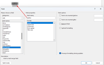

Hello @MM_10991077 ,
I usually manually insert them with the Quick parts > Field function, but without the { MERGEFIELD ... MERGEFORMAT } commands:
Hello EvaBertalan,
I did the same but for some reason it is not working.
the { MERGEFIELD ... MERGEFORMAT } is shown when you press ALT + F9
Below you can find picture with original working merge field and manually inserted via above step.
They look the same but it is not working.
thank you

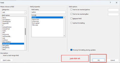

Hello EvaBertalan,
yes, I change it back with ALT + F9.
We use Office365 running on Windows 11 machine.
What confuse me is that it stop works when edit working merge field.
Pure open and close field window is enough.
result:

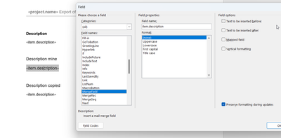

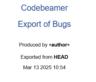

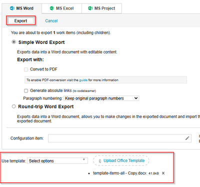

Hello @EvaBertalan ,
I downloaded systems templates from: $CB_HOME/tomcat/webapps/cb/exporttemplates/Trackers
Templates work fine.
Below is example for tracker:
I made a copy of "template-items-all.docx" and delete all fields except Description (line 1).
Then created same merged field (Description mine).
And copy original description from first line (Description copied).

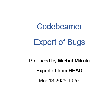

Made export to office:
Result is below:

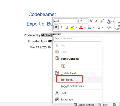

There is also second issue.
I am not able to populate data from header in blue square on the first picture.
thank you
