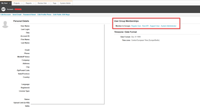

Hello Community,
I am trying to figure out where in database (MySql) is stored User Group Memberships for particular user account.
I found table "acl_role" but this seems to be related to project only.
Goal is to create a query which link user_id with it's roles/memberships in Codebeamer.
thank you

  • This will give all global user group memberships, as seen in the User Group Memberships section of the UI you shared.

Hello pshashipreetham,
unfortunately following tables does not exist in our MySQL database:
cb_user_group
cb_user_user_group
