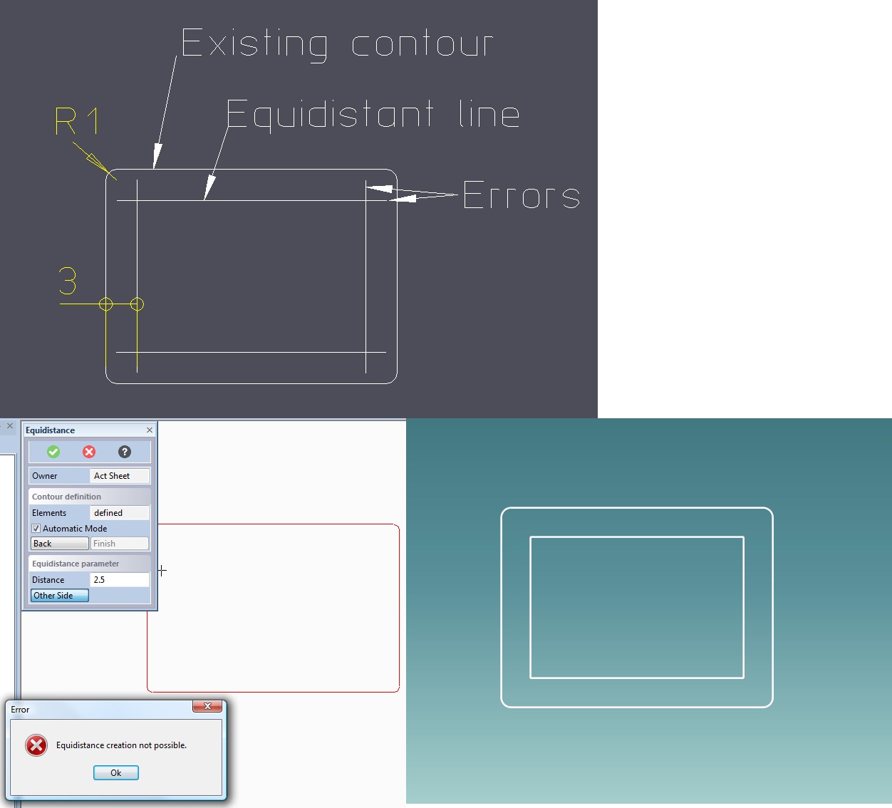

If you want to create in Drafting an internal contour with the command Equidistance of a contour with
roundings smaller than the choosen distance you will get an error message.
Then these unclosed ends must be adjusted manually.
In Annotation you get the message "Equidistance creation not possible"
In modeling on the workplane, however it is functioning properly.
Would be nice if that were improved.
