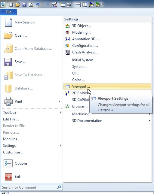

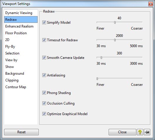

Anti-aliasing settings.  File -> Settings -> Viewport.
Click Redraw.
Regards
Tom
Click Redraw.
Regards
Tom
