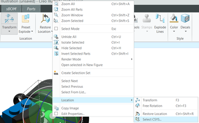

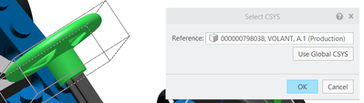

Essentially what the video shows you is the ability to change the csys for a part.
This allows you to choose the csys of another part (for example the hinge) so that the door would rotate around the hinge.  You can also select an axis of a part if you need to be more specific.
Hope that helps.
