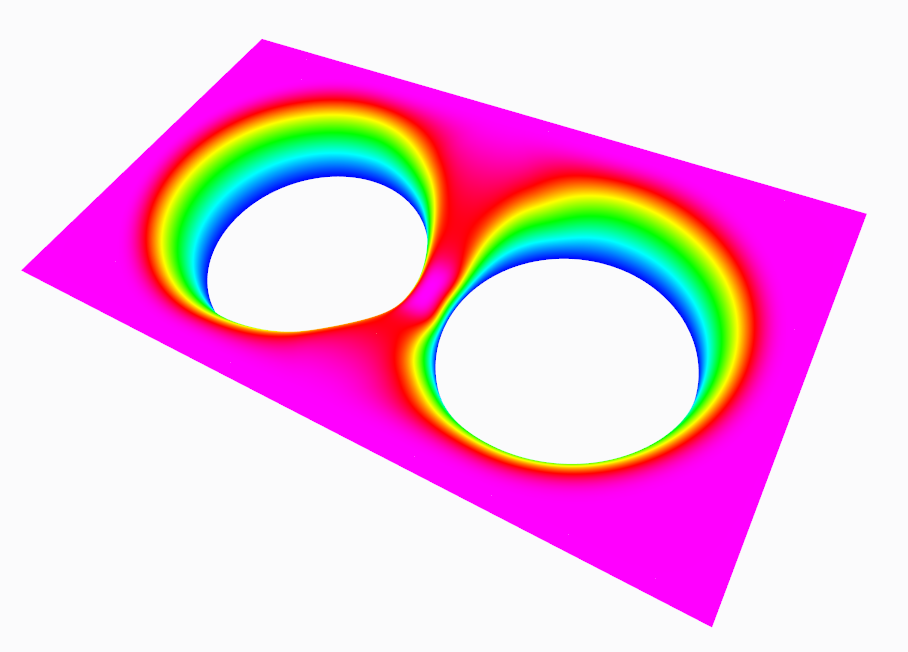

Can you see what the new boundary blend stuff can do with Dan's challenge?
Surfacing Help, 5 Sided Surface and Continuity
Supposedly, there are very new surface blend algorithms added to the core Creo 3.0 that should manage continuous curvatures better than before.
this is the step version..as trial version file would not open in commercial version
That certainly doesn't look curvature controlled
Attached is the best I could come up with yet, but it was way to much work to get the details to work.
The defaults were terrible. Every change blew up the model although it could be healed. Only limited features can do curvature rather than tangency.
may be i missed something...
