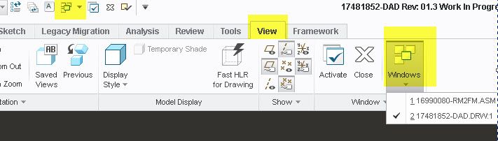

I have the "windows" icon in my quick selection toolbar. It is also under the view tab, Windows
