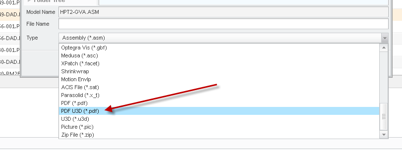

Does the Creo 4.0 View Adapter able to convert Part and Assemblies in 3D PDF ?
If it is not the case, do you know if it is planned to implement this feature soon ?

Yes. File - save as - save a copy and select the pdf u3d (*.pdf) option.
