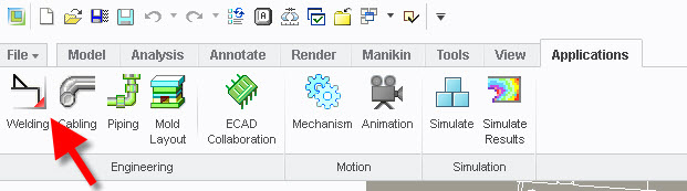

This functionality exist. In your assembly, go to the applications tab, then WELDING.
manjunathrv
I believe this Welding feature is created as a surface than a realistic weld; for representation only, but may not be used for FEA.
