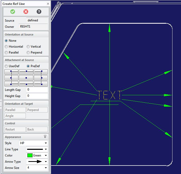

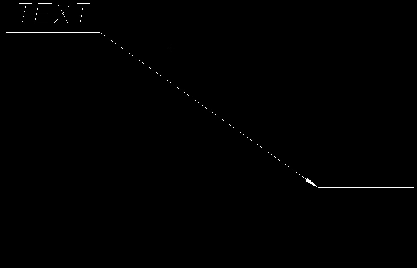

This is currently a limitation because there is no option available which will change the orientation of an underlined reference line in Drafting and / or Annotation.
The underline reference line is Always created from left to right.
The new option can be useful  to create the underline from right to left.

In Annotation, I am able to create reference lines from text that start anywhere I want and go any direction I want.ref_lines.JPG

Hello Peter
It is possible to draw the reference line with any orientation and direction but when you want to go underlined and from right to left you need to revert the normal orientation of the reference line that is left to right and so you need to create a overlapped horizontal segment.
So an option that revert the standard orientation can speed up this process.
