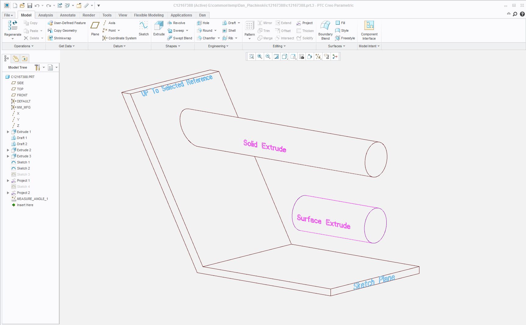

We can extrude a solid “up to selected” that is not parallel with the sketching plane.
Currently we are unable to extrude a surface “up to selected” if that surface is not parallel with the sketching plane. The surface that you want to extrude up to will not pre-highlight for selection.
The functionality exists in extruding a mold volume in mold-design extension. A mold volume is nothing more than a closed quilt.
The functionality is already in the software with solid extrude, I/We are asking for this functionality to be enabled for both solid extrudes and surface extrudes.
There is a work-around: If you select solid extrude first, choose your “up to selected” reference, then switch it to surface extrude; it will only work if your “up to selected” reference is 3.0 degrees or less from your sketch plane.

Here there is another work around movie where shows how to use the "copy and paste" (Ctrl+c/Ctrl+v) to define the target surface for the extrusion feature.... with this trick you can use really complicated surfaces and you can switch the feature from surface to solid and vice versa at any time.
Video Link : 6949
I agree with you when you say that the default extrude feature needs to be implemented with this functionality.
