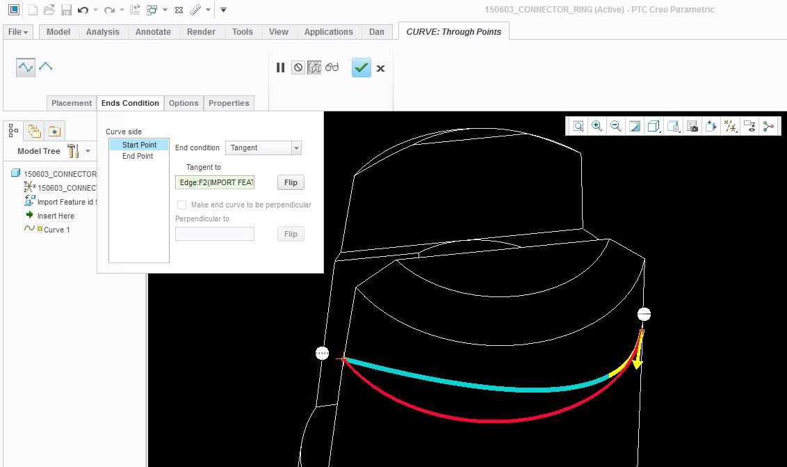

When creating a cure through points in IDD you do not have the ability to define tangent end conditions as you are in Creo Parametric.
Can we add the ability to define tangent end conditions to curves created in IDD?
Creating A Curve Through Points In IDD
Creating A Curve Through Points In Creo Parametric Modeling
