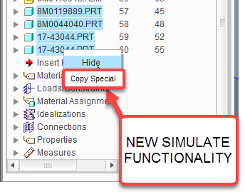

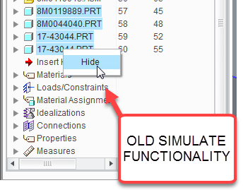

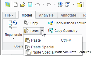

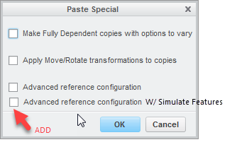

Please Add Ability to Creo Parametric Simulate to Copy Components and or Sub Assemblies with related Simulation Features from one Assembly to Another Assembly and allow you to specify new feature references using Paste Special > Advanced Reference Configuration Include Simulate Features.
Say you have multiple assemblies and you have a common load fixture that you use to apply load in your assembly simulations. Wouldn't be nice if you could set up one of the assemblies with the load fixture and all of it's connecting fasteners, idealizations, contacts, materials, etc. and copy this portion of the assembly with all of its simulation features from one assembly to another assembly and be able to specify the new interface references for the mating components on the new assembly along with the simulate feature(s) references?
Think of expanding the Paste Special command Advanced Reference Configuration to include Simulate Features like all referencing fasteners, contacts, measures, preloads, materials, and other simulate elements.
