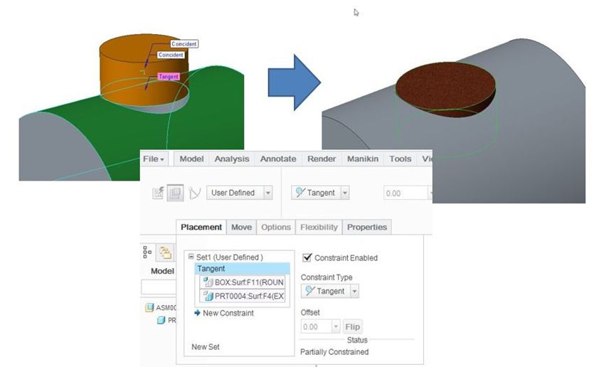

I want to assemble the brown part like right side picture with Tangent constraint. Currently, we need to create additional datum plane.

You always need enough constraints to successfully define the placement of the part. If you don't add the extra one now, the part could flip on you later since tangency doesn't definitely describe the constraint.
