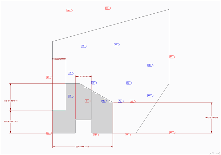

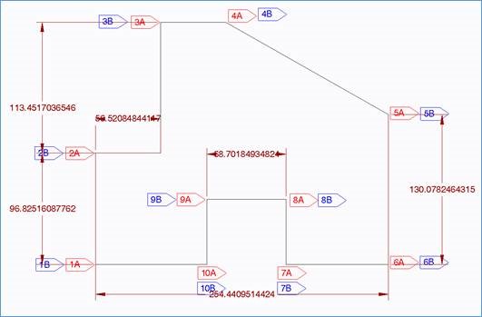

Here's another extreme example that I used to test the results from a PTC support ticket and verify how the views were changing. The response from them was "Works as specified". (Case 12653660)
On the following sample part- All the Red Flags are related to the view. All the blue flags are not related to the view. Dimensions are all model dimensions.
I added a large piece that would alter the size of the view so it would be clear what would move. Original part is marked in grey.
It’s a bit difficult to see, but the blue flags are all lined up in their original orientation around the view center. They’re not lined up with the original view geometry.
The view stays centered relative to the overall center. it’s not based on say the CS0. Even if the view movement is locked it will still re-center because it doesn’t see that as a move.
The red ones and dimensions moved proportional to the size of the view and also moved with the view based on how the view changed. If the view expanded to the right, the flags expanded to be equally spaced along that side of the view.
So I’ve found the following
  • View associated symbols, and dimensions will scale relative to the overall size of the view, even if those individual features didn’t change
  • Views will adjust so that the center point is still at the center of the original view, this includes some changes to the skeletons
  • Non-associated symbols or annotations will remain in the location that they were placed (though everything around them could change)
  • Datum features on a skeleton will not update view size
  • Shapes and sketches on a skeleton will update a view size even if not visible
  • Changing View Origin from Center to a picked location will move that picked point to the center location, or sometimes off the page
  • Lock view movement only locks manual user movement

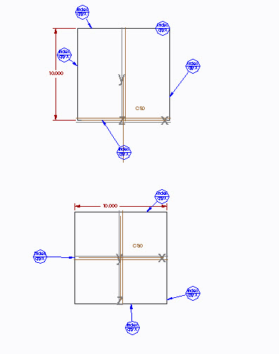

Did a quick example:

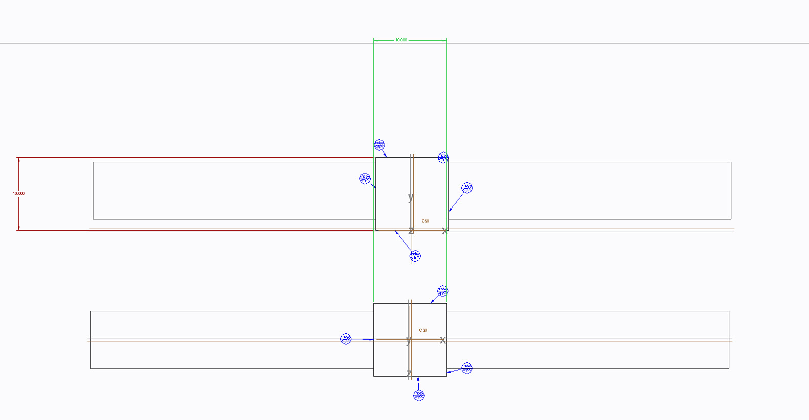

I realize this isn't your use case, but I wonder if the same behavior occurs in 3D...  What if you created the dimensions, annotations, etc. in 3D and then simply displayed them in the drawing on a combined state?  Do they still go nuts?
slapha
So in most of our newer stuff we do use model dimensions and annotations. Tried it out. In both the model and the drawing the symbols remained in about the same spot, no real shifting identified. The dimensions however did move. A real odd one, I changed the model to expand in the X direction, the dimension measuring the width of the original geometry actually moved in the Y direction. The model's overall Y height didn't change. Appears to be a small bug.
The symbols didn't move because they had 3D dependency still active. If you move them on the drawing before the change they move around, but "restore 3D dependency" brings them back to their original spot.
Combined state views for TOP and FRONT
Added additional geometry.
The dimension on the left doesn't look too bad, but if you notice the dimension in green moved when it shouldn't have. Though the symbols stayed, which is something.
Move any of those symbols before making the changes and they move.
However you can move them back with restore 3D dependency and they go back to the view just above this one.
