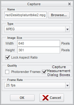

Enhancement request:
Add switch and ability to allow mechanism animate capture to MPEG to capture text in measurement dialog boxes while recording animation to MPEG vides without the need for screen capture software.
Reason for Enhancement:
There is a need to capture the distance between 2 moving parts or assemblies to better communicate clearance between moving parts and where the measurements are located on the parts. An animated video of the moving parts while taking the measurements would help better describe clearances.
This would also reduce the need for a second application like snagit or other screen capture software and steps to create the animations.
