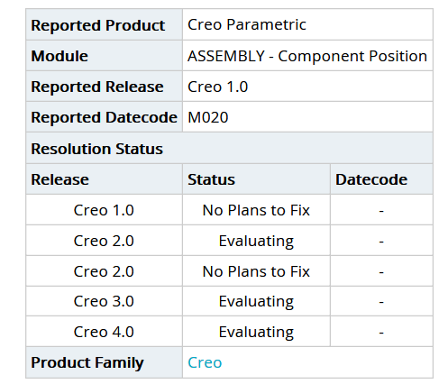

Adding support for tangent constraint applied on a cylinder or hole surface.
Today the tangent constraint applied on a cylinder or hole surface is not part of Creo Parametric Functionality.
The workaround provided below is the current and only solution.
https://support.ptc.com/appserver/cs/view/solution.jsp?n=CS40703
2 Comments
TomD.inPDX
Unfortunately this says it won't happened.  However, the workarounds are easy.
Just put a construction circle on the surface reference and use that for your tangent.
