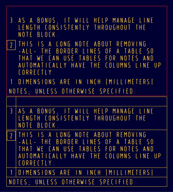

I've wished for a direct way to do this also.  My workaround is to change the table's line style color to "highlight - edge" and then print using a pen table that assigns the "highlight - edge" color to print as white.
ahaas
This would make general notes so much better/easier

Very sad to see this idea not being implemented yet, this could have been a game changer for formats and notes.
