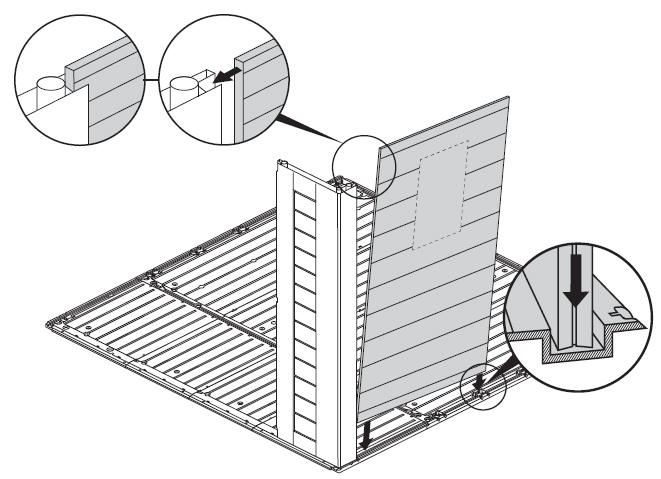

mspitz
I agree with your idea. I draw many assembly instructions, and it lacks a number of 2D tools in Creo to obtain a satisfactory result.
LawrenceS
18-Opal
Marc, I could see how that is a challenge with our current tools...how do you do this now?  FTs? Mechanism? other method?
mspitz
Lawrence,
This is the goal I intended, I don't know which software is used to obtain this result.
With my old 3D software (CADWORK specializing in wood) I can get almost the same result (it's an ageless software !).
I have a good result with Creo, but I can't obtain my 2 goals :
make zoom in circles
color some pieces in white or in gray
or I have to manipulate PDF with an extra tool like Illustrator... but it's very, very long.
I can send examples of my manuals to show you.
LawrenceS
18-Opal
Sounds like PTC should check out CADWorks to get some good ideas!
I have done zoom in circles before. First I use either Mechanism snapshots or FTs to show different positions. Then for the dwg I show the rough detail view, use the pallet to draw a thick-lined circle where I want the boundary to be, relate it to the view (so that it moves and resizes with the view), then under details zoom in and sketch my detail boundary over the thick bolded line using about 5-10 reference points to get a decent circle that wont show outside my bolded circle. This is a time consuming work around but I (eventually) get the desire result
I have no way to do this...perhaps Creo View or Creo illustrate...???
I am curious at the examples you refer to...
