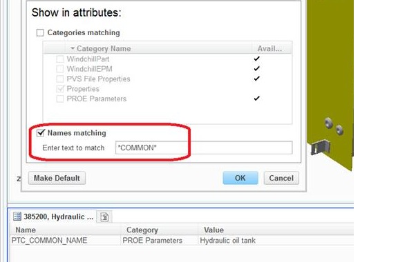

Attribute filter mechanism in Creo View can only handle one condition...
It is not possible to add several conditions in Creo View for showing attributes.
I would like to have possible to choose several attributs. Could be added somthing like this:  *COMMON*;*MATERIAL*;….?
This worked in ProductView 9!

Have you tried the "Bill of Materials" tool and looked at the UI developed within the "Column Chooser" icon available in the Ribbon for Creo View 2.0?  It enables any combination of attributes/parameters to be displayed from Publishing, Windchill or Pro-E.  I use this tool to identify which objects in my tree structure do not have the positioning assembly parameter.  It is very powerful for searching and reporting.
Also go to the Creo View "Options" menu and look at the "Bill of Materials" area.  I generated case number C11317962 to solve an issue where the displayed fields can not be set as default values.
alarson-2
1-Newbie
The BOM tools is quite powerful and useful, however, I believe in the OPs case (and mine) I am reviewing select subsets of components in an assembly.  For instance I have selected them graphically and want to review specific information about them from the attributes pane.  In  that case the BOM tool does not help.
