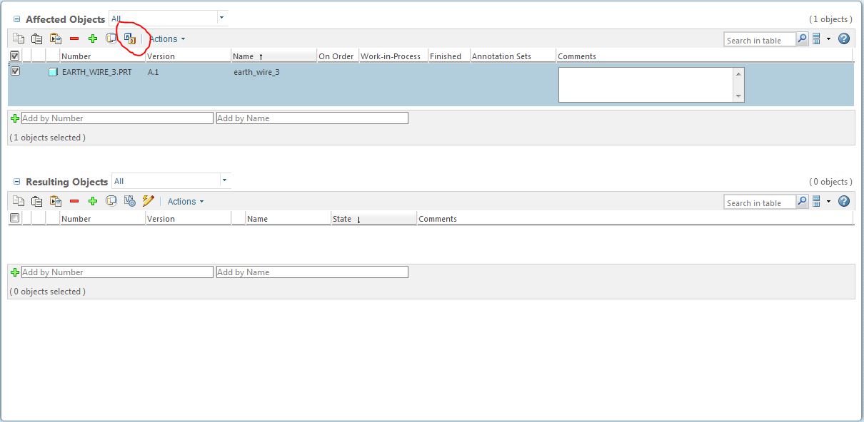

Currently only one option to automatically create resulting objects is available when change a notice is being created.
This is the revise button.
This creates a new revision and in our workflow sets the resulting newly revised object back to In "Work status" from its "Released" status which means the previous revision is still the Released revision until the change has been completed and then the newly revised object gets upgraded to "Released"
However if I want to create a change that will have a minor effect on an object such as a spelling mistake on a drawing or an incorrect mating in an assembly etc. it does not warrant a full revision it makes the transition by iteration for example V 1.1 to V 1.2 instead of V 1.1 to V 2.1.
This is not currently possible. As there is no way to up-iterate then no resulting object can be created. If the Object in question is at"Released" then the change is happening to a "Released" Object (in our system no one can check in a modified released part). It becomes impossible to make an iteration change on a "Released" part without the intervention of a Library Manager or Administrator to set the permissions for the assignee to modify and check in a "Released" part. This is not good.
I would like to see an additional button alongside the Revise button that says "iteration". selecting this will create a new iteration of the object,(exactly like the way the "Revise" button works) and set it to "In Work" status such that it can be modified and checked in.
the Change process can then take it through to "Released" exactly the same way a Revised object is processed.
This would be an incredibly useful feature.

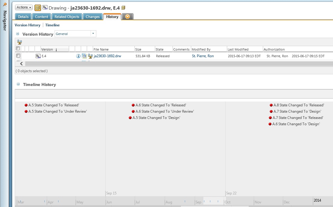

While I am fully for giving access and taking away when abused... this is one area I'd raise caution to.
Comments based on Windchill 10.0.  (and hoping to move forward soon!) so this may be outdated....
Our company adopted a little different philosophy regarding this topic.  The number of people accessing is also a factor but I offer as fodder.

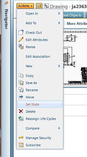

Key individuals were given separate "local admin" login rights to allow objects to have their states reset.  Once the "typo" task was complete, the object is either re-promoted by the operator or the state was set to released by the local admin.  Version control is already built in as you can see.
Now, in the spirit of this request, what perhaps this "button" should do is be able to allow the demotion of an object/collection of objects to those that have this "local admin" right.  If needed, to be able to logout as a normal user and allow to login as the local admin and vice versa.  For smaller companies with few users, this local admin could be everyone but as the number of users escalates, only a select few should be able to do this.
Note: this is currently available to those that have these rights.  It is not visible to those that do not
What I am suggesting is to bump this ability into the search/browse side instead of the detail side.  Reason: the drawing and the model (or other objects like .pdf's or doc's) need to be adjusted also and it would be much easier to be able to select and perform the demotion in one action rather than separate ones.

We allow modifications to drawings without authorization so long as they are clerical.  We try to incorporate them with other authorized changes but sometimes it can not wait or it is discovered a step or two before the production floor.  Authorized changes are revision changes (A.x, B.x).  We do not utilize the promotion request to its full ability.  Its a method to set the state from design to released then use the revise to move to the next revision.  Iterations of a revision level is just saved design states.  The latest version is always promoted as "released".
