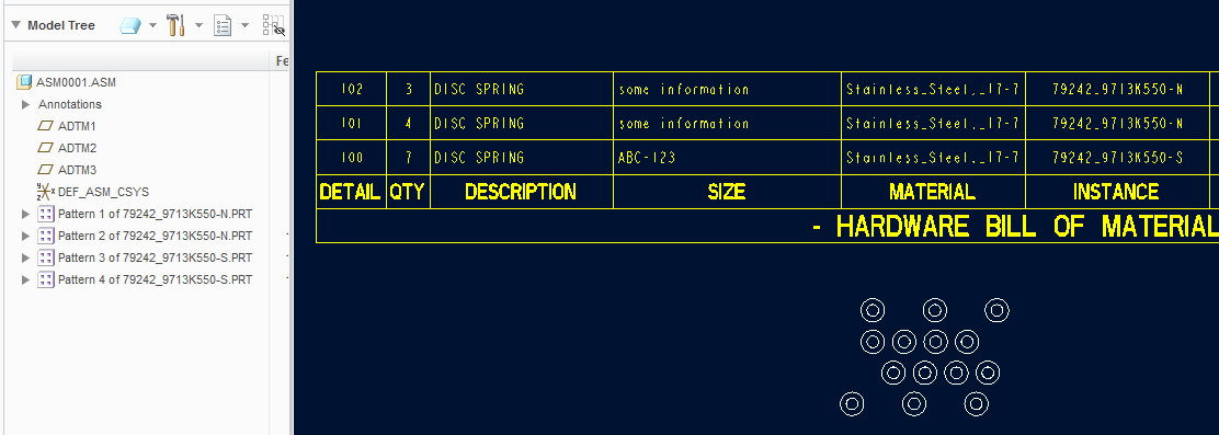

If you have a flexible component or multiple simplified reps of a component that has a parameter with type NOTE in the repeat region the current functionality does not combine the same component into a single row. I would like the same behavior in the repeat region for flexible component and simplified rep components with note parameter as I get when I use a a string parameter. Reference Case# 11800613
