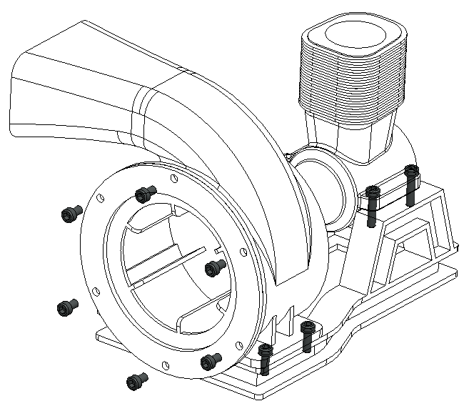

Combined State in drawing does not carry Style
Although you can add a Style to a Combined State in 3D mode, you cannot take advantage of it in a drawing view.
The drawing Combined State should carry style too, so that we can create an assembly view with different display styles for its components.
i.e.: To hightlight one component in an assembly with Shading, while the rest of the components remain No Hidden.

This is also relevant for the export to CreoView. We tried to highlight some parts with shaded display and the rest of the assembly should be in wireframe. The combined view with this style setup was not transferred to creo view as well.

We need this functionality so that we can do the following:
- in different drawing views, we need to selectively BLANK different sets of components to depict installation drawings
- use a single repeat region for placing BOM balloons
Without this functionality, there doesn't appear to be a way to achieve this.
