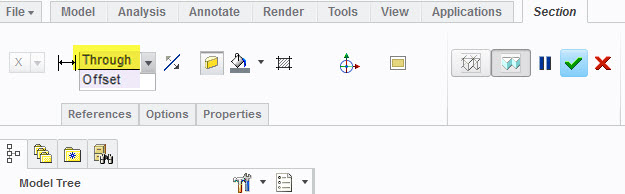

Planar Sections created with Creo Parametric 2.0 generate "0" dimensions after datum plane selection.
As a consequence, "Show Annotations" action in Drawing Views displays lots of unwished "0" which renders more difficult the choice of dimensions to keep.
Please add “Through” by default in dimensioning box (and “Offset” if you need to add dimension)
- No  “0” dimensions by default when datum plane is selected
- If dimensioning is necessary, create an offset plane.

Option has been added in Creo 2.0 M120
    planar_xsec_default_type  through

Per Nicolas' comment, this can be accomplished through the config option:
