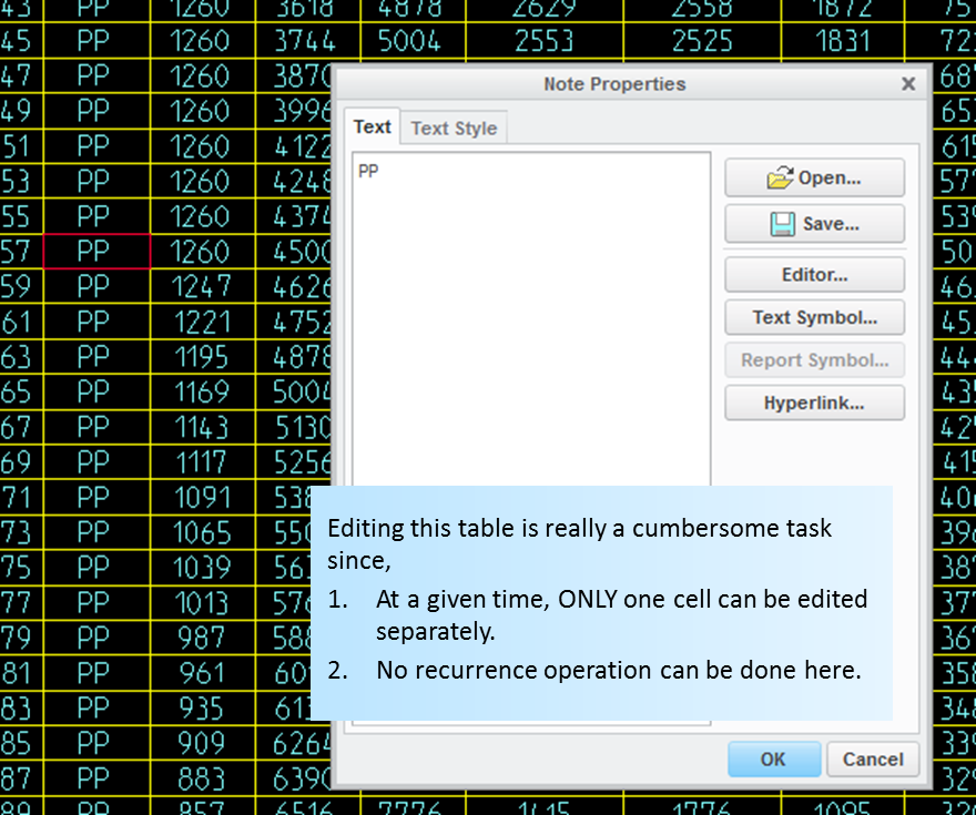

Proposal:
We need a functionality to set Creo Drawing Table editing source as MS Excel sheet.
This is just similar like in Creo part/asm module, pattern feature editor can be set as excel sheet instead of Pro/table.
Reason:
  1. In Creo drawing, we need to create table with at least 50rows X 10columns as shown in figure manually.
  2. Editing this table is really a cumbersome task since, ONLY one cell can be edited separately.
  3. No recurrence operation can be done here.

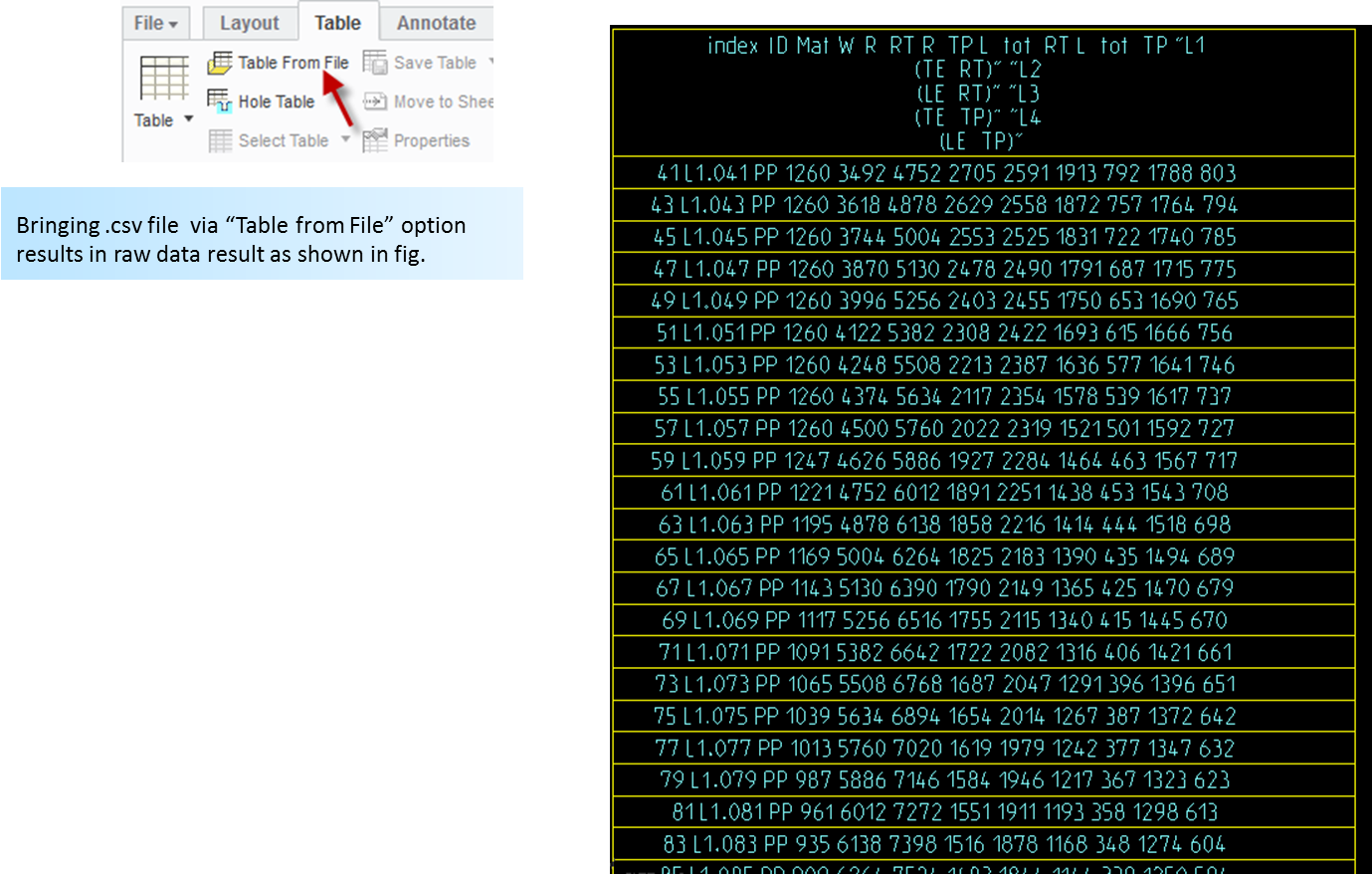

  4. Bringing .csv file  via “Table from File” option also results in raw data result as shown in fig.

Hi Martin,
Here we are talking about two different cases,
  1. Save creo drawing table as csv and then do some manipulation on csv file using notepad or excel to make necessary rows and columns as we we want. Now just save that csv file in excel.
  2. After above task, Bring back that csv file into creo drawing as table. You can notice all rows will become just one row and it's a mess.
I believe you tested case 1 only. Would you test case 2 as well and see how the final table looks like in creo drawing?.
MartinHanak
24-Ruby II
i tested cas 2, too.
  • I created table in Excel and exported it in csv file
  • I opened csv file in Notepad++ and replaced all semicolons (;) by colon (,) and saved it
  • I imported csv file into CR2 M070 drawing and got real table

It is funny we can export table from Creo to Excel (csv_format_delimeter) but unable to setup reverse method when importing Excel CSV table to Creo.
We must manually change semicolons to commas and what is the most tragic for "euro users" all numbers as well. Values with commas are ignored and have to be replaced by decimal points.
5,25 => 5.25
ABC;DEF => ABC,DEF
When it is gonna be fixed PTC? We need more config options to manage Excel CSV <=> Creo import/export according to national formats.
