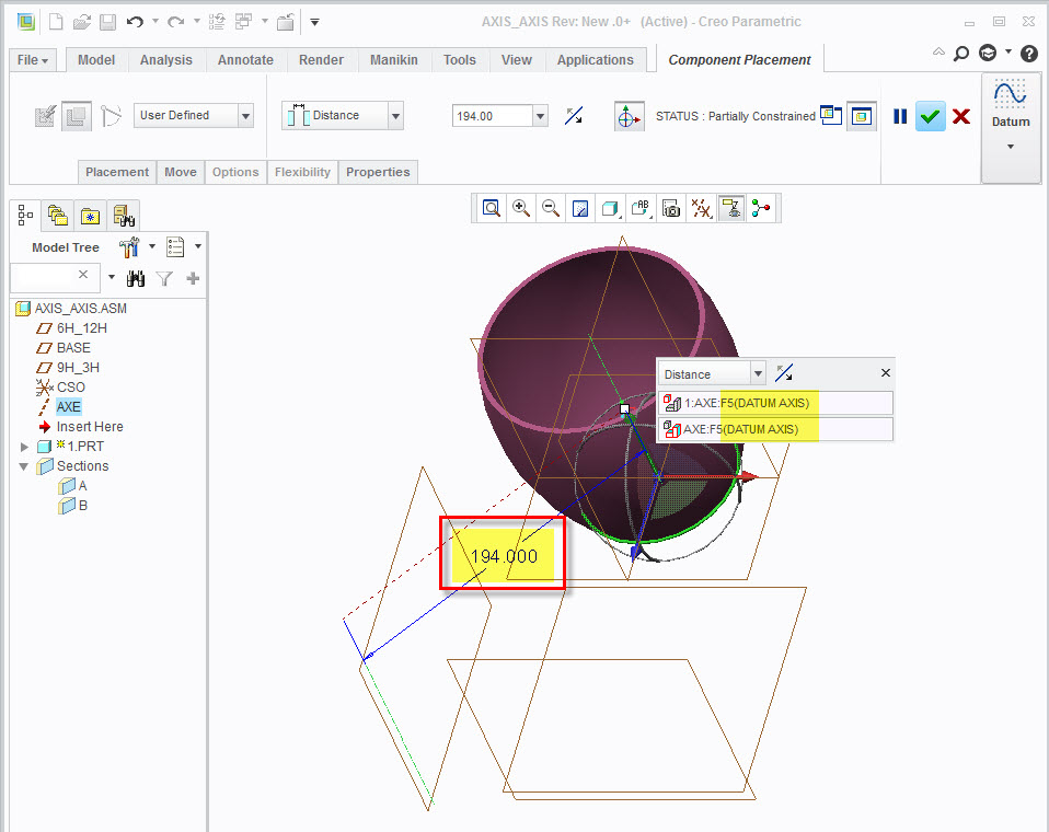

Default choice when assembling two axes should be "coincident" (Creo 2.0)
config.pro option solutions this problem:    auto_constr_always_use_offset   never
Since Creo2 release, the default choice when assembling two axes is now "Distance".
I think that the default choice (most often used) should be "coincident."

Why can't you just put a distance of zero - isn't that coincident?
NicolasBourgeoi1
A dimension of zero will be useless in 99.9% of cases!
I'm wasting time to change this dimension to zero in the assembly. The zero dimensions will appear unnecessarily in the drawing.
No, it is not the best practice to substitute a coincident constraint with a zero dimension.

This option solutions the problem:

In reality, the "new" assembly interface as described in the "enhancement" videos -suggests- that the "improvement" includes -intelligence- by knowing if the object is close to the references or if it is -at distance-.  So if the object is close together, then it will pick coincident, but if they are at some "significant" distance, distance will be selected.
Inoram
Good find! I already set it and tested it.
Yes if they were close it would go coincident by itself. But that seems to be about 5% of the time for me. I am sure if I spent the time to move the part closer to the point of assembly it would work that way, but the time spent doing that would probably be even greater than changing distance to coincident.

@NicolasBourgeoi1, @TomD.inPDX & @Inoram
When we first went to Creo2 I tested this and other config.pro options extensively because this is a very annoying problem for us who primarily use semi-rotationally symmetric models.  There are also some options for them to conditionally coincide or stay oriented/offset.  However, the config.pro really needs to control axis and datums independently of each other.
For rotationally symmetric parts you usually want to constrain to the center axis while often offsetting from a datum (or surface)...such as using an oriented constraint.  However, if you use this option it shifts the annoyance to moving your part from being offset to coincident and you will either loose your approximate location or cause an error.  Of course there are workarounds to all of this but the way it is done now is slower than what it used to be, and it is a highly repetitive action.
I like having the option, but it seems the vast majority of the time axis are used to coincide with stuff, not be oriented/offset.  I am curious, if you have used the orient/offset constraint before, what have you used it for?  I am having a hard time imagining the cases it is useful (although I am sure they exist)
