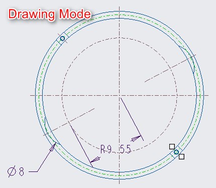

This idea concerns the display of the radial pattern axis in 3D mode.
"radial_pattern_axis_circle yes" behaves as expected in drawings, but allows expected level of display in annotations created in 3D mode only in rare situations (pattern - by axis, by dim or by direction - of a hole created as type radial or diametrical).
I think it would be useful that this display is possible whatever the type used pattern.
Thanks, best regards.
